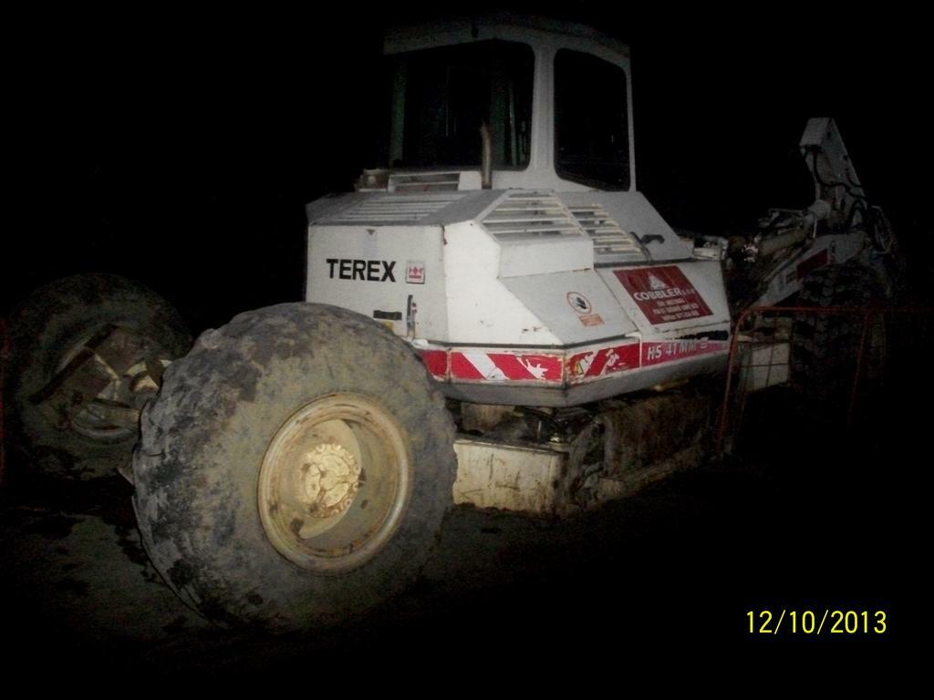

Schaseff HS 41 MM firma Cobbler

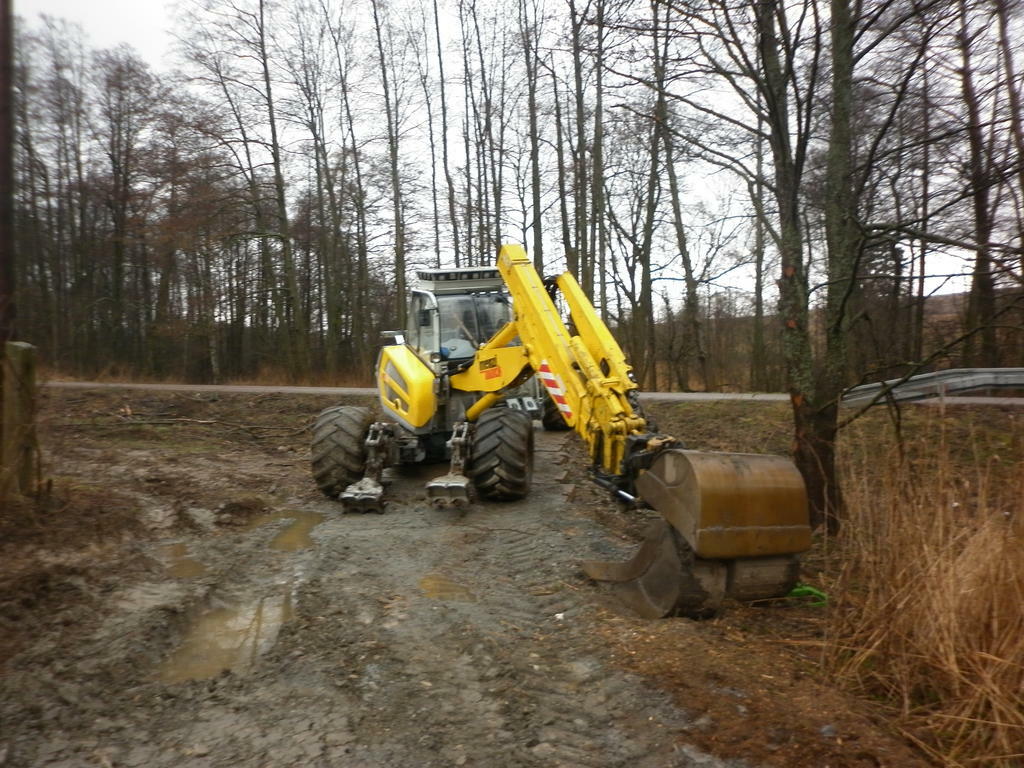

Menzimuck A91 4x4 plus Firma Elitbau
